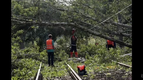

However you approach the rest, do not do this:
[Hearth.com] Bar stuck
Geez... It is like a textbook example of what not to do...
In fact I hope it is staged just for that purpose.
I wish it was staged. These guys should be fired!
This was a pic from a storm that ripped through few European countries two weeks ago.
Actually, given it looks & sounds like a disaster cleanup operation and the wires have likely been turned off - I kinda think he might know what he's doing.
Sometimes it's a fine line though...
(At least he has the gear on for it).
