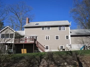

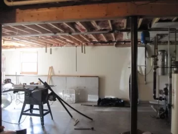

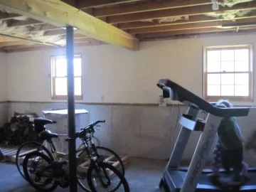

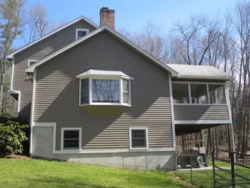

Hi all. I'm looking for some advise on a basement install of a Buck Stove model 85 in my new house. I'm planning to do a Class A stainless steel double wall chimney, but don't know enough about the clearances that I need from certain things. I've got a walkout basement and I've attached pics of both the side of the house and back as well as corresponding pics of the interior of the basement.
Considerations that I have are as follows:
Windows
Propane tank for stove and oven located under the back deck and line entering the house (visible on the back wall of the basement embedded in the drywall.
Exhaust vent for stove. (upper left corner of basement window)
Interior basement partition wall (located just to the left of the cross country skis)
Exterior door located under the screened in porch in the lower left corner of the back of the house.
I'd like to put the stove in the larger part of the basement. We have all hardwood floors on the first floor so the heat should radiate up through the floors nicely. Any advise on clearances to the above obstacles as well as recommendations as to how to set myself up for success are all welcomed. Thanks in advance for your replies.

Depending on radiant heat alone through the floors is not going to cut it unless the intent is to heat the basement to 150::F_g. It looks like there is insulation in between the ceiling joists so the odds of that happening are even slimmer. How will the heat convect upstairs is important, as is basement wall insulation. Is there a stairway to the first floor in the large area? Are you prepared to insulate the walls?
Reactions: downeast
Thanks. I was planning to pull down the insulation between the joists and will likely use foam board insulation on the basement concrete walls for somewhere between an R-6 and R-12. My heat loss from the upper part of the house is not great, although I will need to insulate the walk up attic. The house was built in '90 and 2x6 framed, so the wall insulation on the first and second floors is pretty good. When we purchased we were told that the house uses 1200 gallons of oil per year. I'd like to cut that in half to start and then maybe look into doing a wood fired furnace with 1000 gallons of storage. Thoughts?

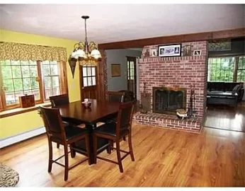

I have forced hot water. I referred to it as a furnace since it doesn't acutally "boil" water. Not sure what the actual term is. The house is 2900 sqft total (1st and 2nd floors) with a little over 1500 in the basement.
attached is a pic of the first floor fireplace which opens on both sides to the kitchen on one side and to the family room on the other side. I was hoping to not use that for the wood stove (as an insert) so we could use it on the holidays for a nice fire in the fireplace.

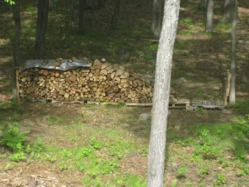

What is your source of wood and how much do you have on hand? If the answer is none, order at least 5 cords now and try to avoid oak for your first load unless you are buying for a couple years from now. This is a big place. It's going to take a lot of wood to put a major dent in that 1200 gallon oil bill.

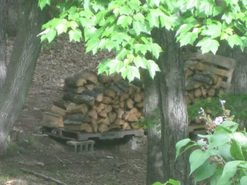

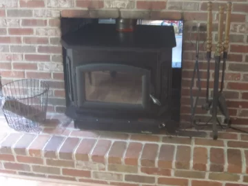

okay.. well, just wanted to send an update.... I decided to take the advice of those who thought I should put the stove in the existing fireplace.. I got a Rock-Flex Deluxe 316Ti 6 inch by 30 foot liner and the insulation kit from Rockford. Getting the liner up on the roof was a challenge but I ended up getting an ascender from Eastern Mountain Sports and used a 1/2 inch climbing rope from my old days of climbing to keep myself steady on the roof. I used some Roxul to block off any draft going up the chimney and topped it off with a standard chimney cap. The pic is of the install and the small amount of wood that I have for this coming winter. Fortunately a lot of it is oak that has been down for 10+ years and isn't rotten. 6000 miles away now with Uncle Sam's Misguided Children, so I won't be able to build the pile any more before the snow starts flying. Of note, the 11x15 (inside measurement) clay tile chimney looked like it needed to be cleaned prior to installation. I ran a wire chimney brush through several times an nearly FILLED a standard paper shopping bag with creosote. I'm glad that I didn't use the fireplace right after we bought the place as we could have easily ended up with a chimney fire. Thanks to all of you who offered your advice for my install. This should keep the wife happy for at least part of the winter.. [Hearth.com] Basement Install:  Looking for advice[Hearth.com] Basement Install:  Looking for advice
Looks like a good start. If you are away it might be worth buying some wood and paying some local boys to stack it.
Is this a double-sided fireplace?
Thanks begreen. unfortunately, even though it would be cheaper to pay for wood, I don't think what I would get at this time of year woud be good for this coming winter. I've got a couple of other stacks around the yard that I can use. I did get started on a 15-16 pile of red oak (below).. Need to do some more scrounging around the yard when I get home and see what i come up with. Fortunately, my new neighbors have invited me to scrounge in their backyards too, so I should be good for at least a little while before I need to start pulling firewood from my other land.
It is a double sided fireplace. I didn't really want to put the insert in there as it would have been nice to keep the fireplace for use during the holidays for a big blazing fire. The insert is facing the larger part of the house and the bonus room behind it should receive enough heat from the back side.
