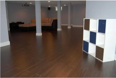

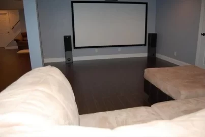

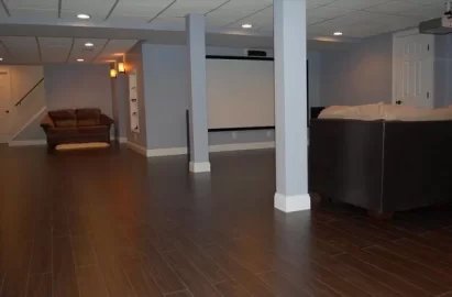

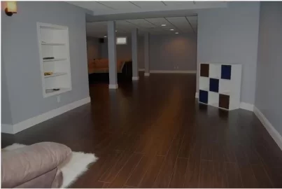

I appreciate the tips from everyone. I've included a few pics of my basement for ideas. I'm thinking a free standing stove on the far wall (first image with the two outlets on the far wall) could heat the space fairly evenly since it's open.

Another suggestion - mine is run thru a window. I see you have one on the wall you were talking about. If you aren't real attached to the window, that would be a great place for the stove - especially with such an open space (assuming there aren't other restrictions on the outside of the wall).

Interesting.. That wasn't suggested. I guess that would be an option, but wouldn't all that piping add a significant amount to the cost? I could well under the pipe outlet on the outside of the house, but I think I'm going to have to go 90 degrees up and vent. I'm curious how I could install an OAK with that setup? Would I have two pipes running up the back of the stove to the ceiling. That might not work from an aesthetic standpoint.
I would run the OAK out the wall. I am concerned about the height of the stack above grade going out the wall. Depending on the footage, if could get pricey. May need to use 4". Anyhow, your tossing around thousands on alternative heat, figured you should at least price it out.
