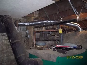

If you have any concerns you can buy fire rated concrete board at your local hardware store, thats what I did to be in compliance with my chimney to ceiling specification here is a pic that kinda shows the fire rated board...BTW the whole install was inspected by the local code enforcement officer who said it looks up to code...Dave
