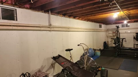

Installed a nice Vermont Castings wood stove in my unfinished basement last fall. It seemed to help a bit, but not as much heat came upstairs as I would have liked. My guess is that this is mainly due to the large unfished concrete walls that are absorbing the heat. My plan for this fall is to insulate the walls so there is less heat loss.
I plan to use foam board insulation. Looking for tips and suggestions on materials/products to use. I've watched a few videos on how to do this and it seems pretty straight forward. Apply glue to the back of the board, and apply it to the wall up to the edge of the foundation. The joists currently have BAT insulation but i beleive there is foam behind them. I'll have to double check.
My basement wall for reference. it seems the best option is to insulate around the sewage pipes and fill in the cracks with expanding foam.
Appreciate any tips/suggestions from anyone who has completed this project.

Code says you can not have exposed foam insulation. That may or may not matter to you. Comfort board is allowed to be exposed. Do you have any plans to finished the basement in the future? Do you really want to heat the basin the winter?

In order to cover over the foam boards on the walls, you could use furring strips (instead of gluing the foamboards). Then you will have something to nail/attach future drywall to. Tapcons for the furring into the concrete wall. Buy a decent hammer drill.
Plan for any wiring.
Also, include the top/horizontal part of your sill plate when installing foam board. You can use the GreatStuff cans to seal that area with small sections of foam boards cut to fit. I believe the rim-joist area is one place where insulation is OK to not be covered with drywall. Someone can correct me if I am wrong.
Maybe just "box out" around those drain lines?;? Would be a pain to replace any of those with spray foam locking them in.

I would have fired that plumber for running the popes the way they did down the wall... Personally if it was me i would frame in the walls and spray foam them this way you can get insulation around those pipes and hide them at the same time. Also with framing out the walls you will be able to rough in some electrical outlets that i do not see any, in the end this will increase value.. I would not secure anything to the wall with tap cons or any other type of concrete screw as concrete does get some moisture in it and that will transfer to the screws over time and then into your wall board.
