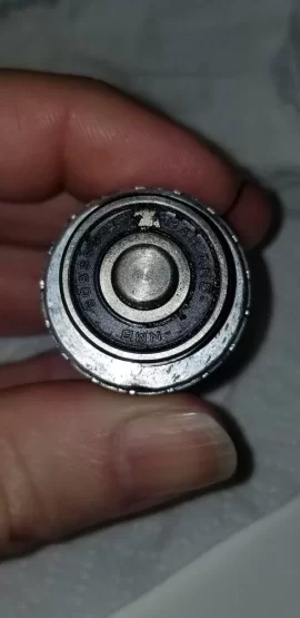

Both bearings on both motors are to the point that I can barely tolerate to be in the same room as them anymore, so I figured I'd try again in earnest to remove one of the seals, even if that means damaging it. These look like they have removable rubber seals like my rollerblades, but after scratching at it for a while it appears to be a rubber coating over a metal shield. I'm not sure if there's a C-clip under there, or if the metal is permanently pressed in, or what. I'll attach a photo of where I removed some of the rubber to expose the metal shield underneath.

Most likely the seals are pressed in. Probably no way to remove them without destroying them.
I just lube mine with 5w30 synthetic motor oil. Suck some up with an animal syringe and put it in the seal area with the bearing held flat. Rotate the bearing and it will draw the oil in. The oil breaks up any accumulated junk that leads to roughness or noise. Which is what I dealt with the first time or two because they were full of old grease. I get almost a season out of an oiling.
You could probably use petroleum based solvent and spin the bearing to suck it in and dissolve any junk. Then suck in some oil and be good to go.
Work a small pick tool under the seal, on the inside edge(inner race), Or a stout pin or needle. Try not to damage the rubber. Work around,pry up.Once enough pressure is relieved, the outer edge will pop out,and you are good to go. Sometimes the metal (the rubber is coating it) will bend, which is OK, easy to put on a flat surface and tap flat, sometimes with a socket and mallet.
Reactions: maraakate
Use the tip of a razor on the outer edge of the shield and pry up, its easy to deform it. They use a very thin grease, personally I'd just replace the bearing if its noisy as it will just come back. The inner part of the shield is the seal, you do not want to damage that.
