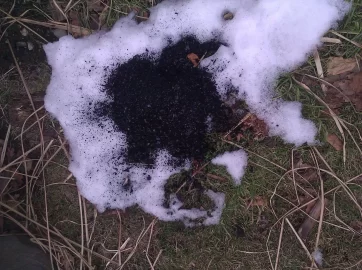

Or all those bodies buried under it! Seriously though, I think I might save the few pieces left for the firepit outside. Like I say, Looks and Burns like it's well seasoned.. I did my 2 week check of the chimney, and after burning this stuff for a few days look what fell out -
[Hearth.com] Beech giving off thick black smoke!
Probably about a cup or so of it.. I'm calling for a real sweep this week anyways
