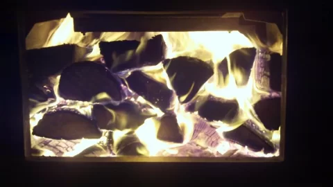

If you turn the fan off, leave the door open longer, leave the bypass open longer and leave the tstat higher longer, the BK will burn any wood clean, hot and long even if the wood isn't perfectly dry.
The scene should look something like the pic below before you close the door if you have any concerns at all about the dryness of the wood or you are doing a cold start. My personal opinion is the real strength of these stoves is how easy it is to burn them for 7 months straight. Once you get into the rhythm of reloads on the hot coal base, it is a 10 minute process.
