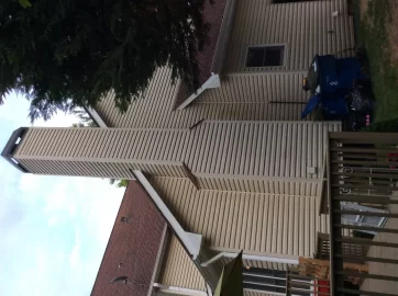

  1. Hi, new member here from Atlanta. Been reading up on removing an old zc fireplace and adding a free standing wood stove in a alcove. I have a Quadrafire,Napoleon,and lopi dealer near by, so I have been considering one of them. House is 2000 sq ft, 2 story. The room that the alcove will be in has a very tall ceiling. Prob. 15 feet.
An issue I see right off the bat is my chimney chase is suspended a few feet off the ground, so supporting the weight of a stove is something that will need to be dealt with. I am sure there will be more bumps along the road, but I thought I would start by asking if anyone has come across a "suspended" chase like mine. I have enclosed pictures. Thanks in advance for any feedback.

Welcome to hearth.com Bob. With some good planning this may be possible. The first thing to check will be the alcove installation requirements for the stove. Check the clearances for each stove that is on the "possible" list and don't forget the ceiling clearance. The chase's inside width will be critical. It looks a bit narrow, but that could just be the photo angle. How wide is the chase on the outside?
If all checks out with the stove choice and its requirements, you'll need to also plan on replacing the flue pipe with class A chimney. Depending on the stove, the weight may not be that big of an issue, but it won't hurt to investigate how the current ZC was supported.
I've got 54 inches across so, I think that will be enough. I was planning on having the stove and pipe installed by my stove dealer, with permits. No shortcuts here. I was hoping to save a few bucks by removing the old zc and brick work, and some finish stone work inside the alcove.

I wouldn't worry too much about the cantilevered chase, its pretty common. The floor of it is usually tied into the floor joist system of the home.

Were any modifications done to the exterior of the house?
No. No modifications to the chimney chase or the exterior. Got pretty lucky. Now I'm on a mission to get stocked up with firewood!
