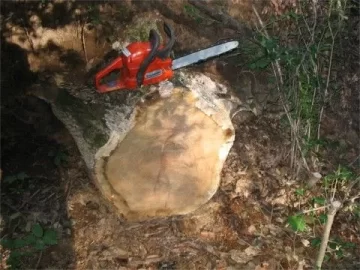

Normally I use the 65cc Poulan Pro 405+ for bucking hardwoods over sixteen inches. When I am just too worn out to lug it I use one of the Husqvarna 142 40cc little saws and run the crap out of it. I can afford to do that just because when I noticed that Lowe's had made a pricing mistake and listed the saw for $99 instead of $199 two different employees kept treating me like a fool and insisting the price was right. So I said the heck with it and bought two of them. I use the little Poulan Woodshark mostly to free another saw when I get it stuck in a tree bucking or felling. The little Poulan cuts great but the vibration difference between it and the little Huskies is daylight and dark. The little Poulan will shake teeth loose.
Of course sometimes just for the hell of it I will do something crazy with the 142.
