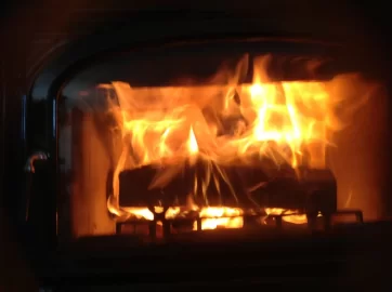

I have the Montpelier as well and I absolutely love it, it heats up our living room and dinner table area perfectly with the best ambiance that is out there.... Definitely consider it and good luck.... [Hearth.com] Best Convecting Wood Insert? [Hearth.com] Best Convecting Wood Insert? the montpelier will give you this, I'm not sure about the others, sounds like you know what your needs are so keep learning....
