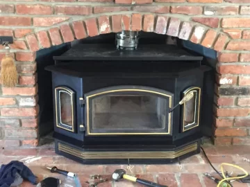

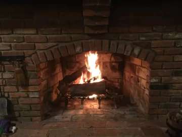

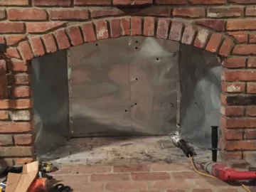

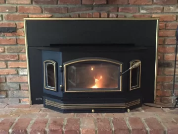

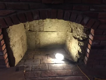

Just finished a similar project this week. Refinished Quad 5100i, exterior 13x13 masonry chimney, insulated 25ft liner, Roxul insulated firebox covered with sheet metal and block off plate. Ended up cutting out the damper and the top two middle fire bricks to fit the liner through.

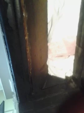

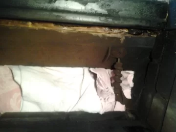

Real nice and the sheet metal would work best for me in the rear due to limited space. Doesn't the roxal get compressed when you secure the sheet metal and is that ok to do? What did you use to secure it to the walls. What type of screws? I tried to post photos from my tablet and I don't think it worked. Oh well. I will try it from this computer and thanks. Those are towels stuffed up there temporarily. The damper door is removed and the back of the damper frame snapped off cleanly at the hinges so its the smoke shelf in the rear and the cast damper frame and lintel in the front. I am sure you know that. Thanks
Tapcons which are screws designed to bite into masonry. You run them in deep enough to snug the sheet metal to the insulation but not deep enough to totally compress it.
