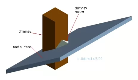

I have searched the forums and the internet, but I have found no satisfactory guide for designing the chase to be trouble free. I have already built a cricket to route water around the chimney, and I plan to either pour or buy a concrete piece for the top flashing because I want it to be angled well to drain water, and steel rusts/is not reliable/is not sloped as much as I want.
The attached photo is practically identical to my situation. The fireplace is on the first floor, and the chase will be built outside a current exterior wall. The wall is at the upper edge of chase, where the chase meets the roof and cricket in the photo.

Well first off start by forgetting about a cement top. It is just a problem waiting to happen that much weight on top of a relatively lightly framed structure is not a good idea. Use a stainless top plate cross broken to give you pitch. As far as insulating it you can do that as long as the manual says you can. But if you do make sure the chase is sealed and completely insulated. Any uninsulated areas will cause condensation. And i would not bother with the durarock if you follow all of the clearances there is absolutely no need. But really if you are concerned with safety do not install a 20 to 30 year old appliance whose expected life span is 20 to 25 years. I personally would not worry that much about the chase yes there can be issues but if you follow the instructions and use good building practices you should be fine. But you should be aware that you will get little to no heat out of this fireplace they really are not good heaters at all. In the instructions it says it is meant to only supplement heat in one room not to be used as a heat source. I just think you should be fully aware of what you are putting in before you put the time effort and money into it.
