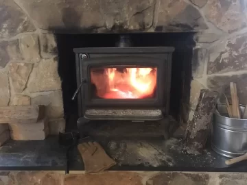

I have a PE Summit (3.0 CF firebox) stuffed in my fireplace. I don't remember the dimensions exactly, but I'm positive your fireplace is larger, and significantly higher.
A cheap fan blowing at the stove helps push hot air out of the fireplace enclosure on the really cold nights.
In a perfect world, the more stove sticking out I think the better, but stuffing a top vent in a large fireplace isn't a bad setup at all. If its the choice of a smaller 2 CF stove pushed out of the fireplace or a 3 CF stove stuffed in, I would opt for the larger stove any day.
This will also eliminate your side clearance issue.
