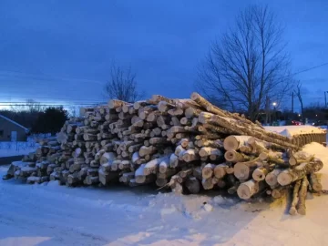

Thanks for the thoughtful reply. My supplier is the very best when it come to laying out logs for me with an eye to not getting myself killed. But I don't have any large equipment that would aid in lifting/elevating the wood to make it easier to cut. Maybe I can swing that with next years budget, but we just finished a complete gut/reno on the bathroom, so I won't be doing anything this year except for cutting/stacking/sellin wood for the remainder of this year. But having said that, a fella on the other site told me about the Stihl 25" ES Light bar that sounds just like the ticket to help me out; at the very least it won't be adding any weight to the saw whilst giving me an 8" extension on what I'm using now.... I'm really tempted by the 28" ES Light bar as well, but also afraid that it might not perform as well on the 440 as the 24/25"...... Thanks to all of you who have been replying. I appreciate it.

Nice stack of logs. I'm not seeing any logs in the picture that I would personally want a 28 inch bar for.
You will probably be happy with the 25 inch bar and it's a great match for your saw.
Lots of wood to process !
Reactions: Chuck the Canuck
Your 440 will handle a 28" fine. Defiantly get a reduced weight.
That stack of logs looks like 026/260 material to me. Your back would love you if you got one.
