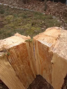

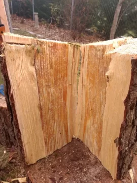

Regarding Blaze King, I recently got some pitch pine. The name is correct...
I asked if it was too much, and it's not. In fact secondary burn (cat or tube) is meant to deal with such smoke.
Pic shows sap drenched sections. (The darker stuff - all waxy and semitransparent from the sap).
