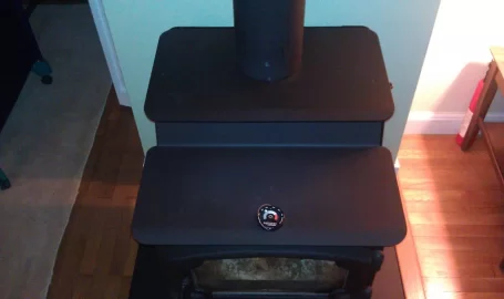

Ok, here are some photos to better explain. I am thinking the the first photo, placement above the door will have lower temp readings and make me worry less?
Here is thermometer above the door:
[Hearth.com] Best Thermometer Location
Here is the thermometer in the middle of the stove top:

Mine's in the center of the stove top, which fortunately or unfortunately, is the top-loading door. I have always suspected that flame impingement and the relatively small mass and volume of this door makes it a little more reactive to be a great indicator of "stove temperature", but everywhere else I try on this massive stove is too slow, to the point where it lags what's going on in the firebox by a half hour or more.

isipwater, I'd go for what you call the "middle of the stove top". I think that'll be more representative of what's happening in the firebox than your other position.
Reactions: isipwater
Any idea why the Endeavor model would say to place the thermometor "above the door" though?
Thats where I've got mine right smack dab in the middle of the bottom level. On my liberty that is definitely is the hottest part of the stove that I have found
