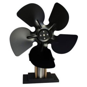

Hey fellow wood stove enthusiasts!
We finally have our BK Ashford installed and are loving it. There are a few accessories that I've seen recommended and I wanted to get everyone's take on these.
1. Is it useful or decorative
2. Is there one you recommend
3. Are there other accessories you love using with your stove
First: The Stove Top Fan
Second: The water kettle
Third: The chimney thermometer
Thanks everyone!

I'll go, since everyone seems a little shy right now.
EcoFans(heat powered stovetop mini fan)
I have one, after the first one died after giving several years of free assistive convection.
They ARE different.
My original was 3 blade, 5" width. It MOVED the air. I found it hard to imagine all those people thinking they were useless, toys, or cosmetic. I believe it got heat soaked, which will kill the peltier module...(electronics that make it work)
My new one this year is being 'tweaked'...It's a 4 blade 5" width. This one's designed for a Mr Buddy propane heater, but it's also a stovetop.
It's blades are terrible, barely push any air. I'm setting blades now, but honestly we haven't burned this year more than a handful of low burns so i can't tell you the final result.
HERE is a tip. Make sure the one you try has a Bi-Metal strip on the base. This is supposed to protect the module by lifting the foot off the stovetop if it gets too hot.
Here is a hack. You can buy modules off Ebay, Amazon for a dollar or two. Get a DVD/CD player(PC)at a thrift store for the motor. Use a chainsaw cylinder head for the heat sink. Buy aluminum fan blade off Amazon/ebay.
If you/someone can wire/solder you can make a multi-fan for a small cost.(Ecofans are high this time of year)
BONUS/ when the power is out, your ceiling fan, room fan isn't going to get warm air to the far areas without 120v. The Ecofan will stir the air.
THIS is important. YOUR stovetop temp determines the fan RPM. If YOUR specific stovetop only gets 340F, you are not going to get high CFM.
I have a sheet metal Fisher Grandpa Bear from '75?. When the stovetop temp clears over 624F, the fan wants to take flight. It roars, and You can feel circulation 15 feet away.(the old one, #1)
No brands, just recommend wider the better, and get a safety bimetal foot in yours. I bought the 'build your own' parts above, just no time yet to get to it.

Cool hack idea. I'd love to see it. What do you mean by modules?
I have the stovetop fan and it does move some air. However having a top -loading stove means I have accidentally whacked it a few times with a split of wood so the blades are bent and it wobbles. The blades are pretty easy to bend back but hard to get it perfect. So if you don't abuse it, it's a nice little fan.

Stove top fan is awesome, but I'm unsure that it actually does anything other than look neat. I would like a second one for stove #2, which one is best? Ours is off Amazon and seems pretty good.

You have the BK Ashford, just get the fan kit for it. I didn't have it for my first season with my Ashford and after installing and using it for the past couple of seasons it really helps move warm air (in my situation - everyone's is different).

They ARE different.
I have 2 Ecofans running on top of my stove. As burning VC experienced, one of mine died after a number of years. However I was able to easily bring it back to perfectly new condition by putting a new electric motor in it. EcoFan sells replacement motors and they are really easy to install. No wire soldering- they plug right in. The reason these motors fail, is exposure to excessive heat from the stove. The motors contain magnets, which permanently weaken when they get too hot. I actually found this out when my first fan was brand new. I had it sitting on top of the cold stove and I started the stove in a manner I usually never do. I had a lot of very dry old sticks I wanted to get rid of. So the fire started very rapidly and quickly became a hot inferno. This cased the stove pipe right next to the fan to throw off intense heat. Meanwhile the stove top had not yet heated up enough to get the fan turning. When operating, the fan itself will pull cooler air over the motor and keep it cool, but if it not running, and it has a close to red hot stove pipe next to it, the intense heat will kill the magnets. Fortunately EcoFan gave me a free replacement motor, so I started right off learning how to replace them. I subsequently bought a second fan. After about 5 years the first one started to get sluggish, so I replaced the motor on that one. I have another motor on hand for when the second fan needs it. They key to making these last, is not to run them too hot, especially when they haven't started running yet.
We had our stove cranked at the camp during deer season (it was about 15 F out) on the last night and the Ecofan started to smell HOT setting off the smoke alarm. So I am wary of them.
We have all been there, thinking we need those things. But you don't. The one you might get it the stove top temp gauge. When you know what your doing just look at the fire. For me, I don't run hot enough to boil water. A fan type humidifier works much better. As to the fan it's a great novelty. Just make sure you can explain to everyone how it works.
