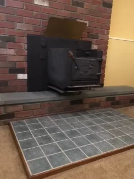

This was how the pervious owner had it setup. Very similar at my house.

I would leave everything closed up, sweep it from above then vacuum out the Tee without removing the stove. I’m assuming you can see through the flue collar into the Tee?
If you can see the Tee you could probably spin it through the stove.
No I can't access the tee without removing the stove. There is a chamber at the rear of the stove in front of the stove's rear exit that can not be removed as far as I can tell.
At least the stove doesn’t weigh hardly anything. Shouldn’t be too bad.
