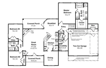

So what would be the best way to get the heat distributed through the house? My Wood stove is setting where the pic says gas logs. Also is this considered an open floor plan? I have read on the forums that if I use the fan on my central heat and air that I lose a lot of heat. I do have ceiling fans in all rooms. Also ecofans. Are they just a gimmick or should it be something to really consider? The ceilings in the wood stove room are 12 feet. The rest of the house is 9 foot ceilings. Thanks guys.

Looking at your floor plan I would suspect its fairly open, the master bedroom maybe the hardest to heat but it shouldn't be that bad since most people like cooler bedrooms when sleeping.

It looks like an excellent floor plan for heating with wood and a nice, central stove location. I would call that "open" since all rooms open into the great room in the middle.
You'll be just fine. No need for extra circulation unless you're one of those folks that insists on even temperatures within a degree throughout the home.
Agreed, the house should heat pretty nicely with the stove in that location. If you like the bedrooms a bit cooler then it should be finre. The MBr bath will be the coolest. Maybe put an electric towel warmer in there for a little supplemental heat? If you do find the MBr a bit too cool, remember that it's easier to move cold toward the heat. Is there a basement in the house? If so a dedicated, insulated air moving duct with a quiet fan could pull air from the MBr bath and blow it into the main stove area.

KennyP the stove I have is the Hearthstone Mansfield. Begreen I do not have a basement so that's not a concern. Hibeam I am not one of those folks. I like a cool bedroom. Woody I'm not sure I'm tracking on the mini split comment, but I think I am on the ceiling fan comment. Your saying to run the fans in the stove room but not in the bedrooms?
