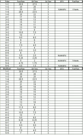

Ben,
I do have a feed trim button on the Omega. Its what you think. Adjust's the pellet or fuel feed times. I made a chart for mine. I will post it if I can find it. So each heat setting has 5 seperate feed times. I usually run the multifuel in the lower feed trim settings. I liked feed 3 with trim in the 2 setting.
I don't have the Comb Air trim, Wish I did. I am hoping Enviro has an upgrade for the Omega someday. I could trim the air for rich fuels with the control instead of the damper setting.
You can try straight corn in the pellet mode. But I would trim the comb air to max and drop the feed to the minimum inthe heat range (4-1). I used this for the switch grass pellets I tried. It worked pretty good. I didn't try it with straight corn though. I only tried switch grass and 60/40 pellet/corn mix. Both worked well.
Have fun and Happy 2010 to you.
jay
P.S. I found the chart. I timed these with a stop watch and recorded. Not sure if the times would be any where near the same for the M55. I have a 3 RPM auger and the M55 has a 2 RPM auger. So I am sure Enviro changed the feeds. But you can get an idea of what they are doing.

Jay,
You are right. I tried corn in Regular Pellet mode, maximum combustion air trim setting and feed trim untouched (I'd guess it's factory set at 3). Heat level was set at 4.
It's been working nice all day today, with very decent heat output (measured at 400°F, pellets being 430-490°F for the same settings). The stove was in Hi-Lo mode and allowed to idle as often as needed because it is very mild here today.
When the hopper empties tonight, I will resume testing ash level with a full hopper of 100% corn.
