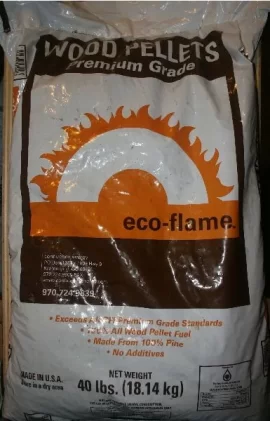

Eco Flames are done. Right at the 16 ounce mark on the jar. I will weight them Monday.
Green Team is in. House it at 76ºF so no temp until tomorrow morning.
