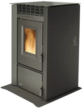

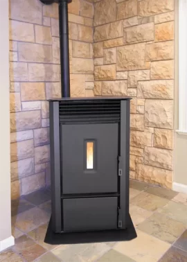

macman,
Here's a couple of pick's for you. You looking to step up in stove's????? I will bet you the M55 or the VF55 FS will keep you toasty! :lol:
Summit,
What are you getting for the VF55 FS? I got a friend looking at the M55.

jtakeman said:
macman,
Summit,
jay
VF55 run @ 2800... pretty good unit, it can run forever without having to clean the pot because of the mulitfuel agitator... and its acutally pretty quiet even with the extra motor: Only two cons that i can find since we got one hooked up at the shop
1. the brick looking backing behind the pot is made of ceramic fiber, so it must be handled w/ care
2. the distribution fan, while it looks fairly robust, does not put out as many CFM's as I would like.
We sell the Maxx with Small glass Door @ $2,500 and with large glass door @ $2,700.00
The M55 @ $3,000.00
