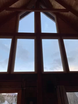

Location is central and about our only option. Small place. Here’s the area where the pellet stove is now. Open room, kitchen to left and living to right. Back is master and bath and stairs to basement. Stairs up to second floor with shallower pitch roof as well.
We sit on a ridge in a bit of a valley with higher hills around us. Realized I mixed up a measurement before. Main floor is about 24’ wide and 30’ deep, thus steep pitch up front.
