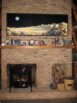

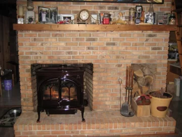

My wife and I just installed a Jotul F 600 in our 2800 sq. ft. home last February. The upstairs where the stove is located is about 1500 sq. ft. with a cathedral ceiling in the living room and sleeping loft over the kitchen. I would recommend going for the F 600. It is a beautiful stove and easy to operate and throws good heat. I don't think you will have any problems with over heating with it since it will run fine with smaller fires. In fact. we didn't have all that much real cold weather after I installed our stove at the end of February and I had no trouble regulating the temperature of the house. We installed our stove in front of a large fireplace on a raised hearth with the SS liner going up the interior masonry chimney. Here is a photo if you haven't seen one from an earlier post.
[Hearth.com] Big Stove, little house? [Hearth.com] Big Stove, little house?
I think you'll be very pleased with the Jotul, particularly if you get a good price on it. We paid $3150 for ours, but that included the Brown Majolica porcelain enamel finish.
