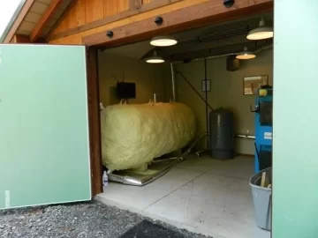

I just added a 110 gallon pressure tank to the system due to my pressure climbing while heating the storage...I have had the house running on the storage for about 3 hours with no drop in the temp...I installed thermocouple in the top and bottom of the tank so I get to see the temp different across the tank...has anyone one had any experience with spray foaming a steel tank (ie my 500 gallon thermal storage
Ya mean like this?
[Hearth.com] Biomass 60 Fine Tuning
Ain't it purdy. That's 3-4" all over. Works great.

airlina that looks like a nice boiler room.
What is the black box above the storage tank?
It looks like a TV with rabbit ears, but I guess rabbit ears don't work in the digital broadcasting age.
At first look, I thought you had a TV on one side of your boiler room and a lazy boy on the other side.
It is indeed a TV above the storage tank. Last year I was batch burning due to no storage yet and made a lot of trips into the shed ,so a tv went into the man cave . And yes rabbit ears still work ! Did some test burns this past weekend as the weather was chilly at night, and I am finding the process now with storage is load boiler to the top and let it burn, unlike last winter where I would match the load to the heat load. I am starting to realize the convenience with storage that everybody talks about. Bruce
