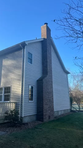

Pictures would help us diagnose your troubles.
How tall is your chimney?

The chimney is about 30’.

Chimney is certainly tall enough, cap is not a big deal. Screen is not necessary unless you do get critters in.
How's the lay of the land. Hills, tall trees nearby?
Wind curls down after passing a tall object and that could lead to downdrafts.
I'd pull out the unit and see if the liner is properly connected to the exhaust of the insert.

Yea I’m concerned about the land part. Directly behind the house we have a hill. A stone drop off. I was thinking that might be some of the issue. That’s why I was thinking the chimney exhaust fan for when downdraft is an issue I could just turn it on to suck it out. I don’t know enough about them yet but apparently you don’t always have to have it on when using the fireplace.
I’ll definitely pull the unit again and check the exhaust. Thank you for the advice
