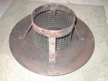

i don't think the mesh I had was some sort of smoke filter. Maybe that's something different.. Here's the kind of thing I've got, but now my mesh is gone....pretty sure it's just for birds.

WHat are you trying to accomplish with a screen?
Keep birds and other animals out 3/4" mesh is not a spark arrestor those are at most 1/4" mesh and they clog in no time

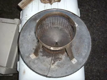

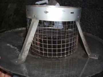

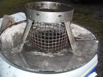

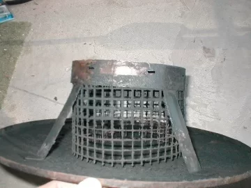

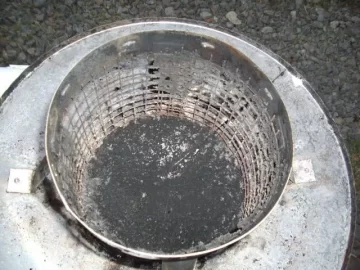

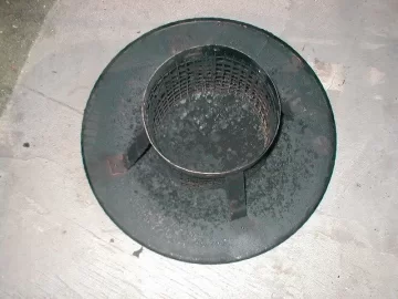

I have the DV cap with screen , and aside from first year poor burning techniques and poor wood( my user errors), I have never had a clogging issue since.
As much as some don't want to hear or admit that maybe their burning habits may not be as good as they think, a cap screen can only be a reminder.
8 years, no screen clogging issues, not even close.
First 4 photos are from 2009 cleaning. last 3 are from 2008, when not as dry as wood as I would have liked was used, but still acceptable for me by my standards.
And I don't even have a cat stove. The proof is in the pudding, or photos I should say.
Cry all you want about a clogged screen, just means your burning habits, wood or both are subpar. If your clogging a screen with even 1/2" openings, the issue is you and the wood, not the cap screen.
Easier to blame the cap screen, then admit you may need to adjust how & what you burn.
To each their own.
I know what I have, and how it performs, and the pictures back it up. Anyone can achieve this, if they want to, not that hard really.

Hogwildz, that's some pretty efficient photos records you keep there. Really useful to see progress in that way. Thanks.

Well, given everything I've learned here I think I may put the mesh back in late spring. Its a wide one so i think I'm burning well enough for that and even if a bird gets in at some point I will at least know it wasn't cos of something I could have done but didn't.
