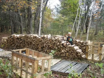

This year we burned 5 full cords. About 25% was properly seasoned so I can't count this year as indicative of the future. For this coming winter, my intent is to have 6 full cords of properly seasoned wood. I currently have 2 full cords cut and split and stacked plus another full cord waiting to be split and stacked. I purchase permits to cut in the local forest. $25 for 30 days. Its not hard to pull two full cords out in a single day with two men. So while not free, its virtually free.
I pull the ashes out once a week with a scoop and a 2.5 gallon bucket. It works out to 1.5 buckets (or so) each time. I take the ashes and put them on the snow in the forest.

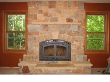

  • [Hearth.com] bis Trdition 4 cu ft fire box
I have several friends from college that live in Holland/Zeeland. We have a cottage in Cadillac and some friends in Travers that I ride sleds with. I am about a hour and a half South of there. I have a few jeeps one CJ-7 completely re done, glass body, spooled 9" Strange Ford, Dana 30, 4.56 gears, 8 point cage, soon to be 407 on juice, 904 with transbrake Silverlake toy. I also have a 86 Wagoneer , 17 inches of lift 40" Swampers, Ford 1 ton axles, 727, fuel injected 360, rock-mud toy. I would have thought that you would have gone through more wood than that, it's nice that you can get the wood permit to cut on state land. We use to do that in Cadillac for the cottage.
Fireplace looks nice, can't wait to get mine done.
