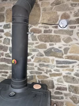

This is helpful. I am relatively new to the Blaze Kings, so I wanted to ask a question.
Is there such a thing as too much draft? Mine will be going in an existing fireplace, with about a 40-42 chimney (straight up). Should I be considering a damper for the stove?
Thanks.
Yes, there definitely is such a thing as too much draft. BKs are particular, but any stove might have an issue with a 40' flue system. It may take 2 dampers to tame the draft down, unless this area is a negative pressure zone.
The simple answer is "yes and yes".
Note that BK won't officially advise using a damper, because of some legalities. (So don't ask them - they'll be evasive.)
There are folks here running BKs with dampers on chimneys with too much draft, and they are very happy with them.
If you want to do things perfect, get a measurement of your draft. A Dwyer magnehelic gauge. Make sure you get one in the right pressure range (around 0.06 wc, I believe).
begreen and stoveliker already said it, but as someone with one of my two Ashfords running on a chimney with pretty offensively-high draft, perhaps I can add to it.
High draft will not create any control problem for the Ashford. Even with my 30 feet of pipe and 0.21" WC draft, I had no control issues. But you will suffer in both efficiency and with the amount of fly ash stirred up by the air wash system (keeps the glass clean), which will eventually plug your catalyst, if your draft is way over spec. It's best to install a key damper (or two) to get the draft in spec.
For the Ashford, unless they've recently changed it, 0.06"WC is maximum, and 0.05"WC is optimum. I assume "optimum" is the draft spec at which emissions or efficiency are optimized, but I don't recall seeing that defined int he manual. To track this, I second stoveliker's suggestion to install a magnehelic, plumbed into the pipe below the damper. Here's my rig:
Great, thank you for this. So if I have the option of running the pipe straight, or adding an elbow, in theory going with the elbow should reduce the draft, right?
Elbow will reduce draft, yes. Rule of thumb is something like an effective reduction of 3 feet of chimney for each 90° elbow (or is that "pair" of elbows, @begreen?). The second rule of thumb is you want that elbow as high off the stove as is practical.
I'm guessing you don't want to slam an elbow right onto the stove collar, if you can avoid it, even of your ultimate goal is reducing draft. @BKVP may have some insight on that, but based on things I've seen him say in the past, I think they aim to get the elbow at least 30" above the stove collar. There may be an exception in your case, if your goal is to intentionally reduce draft, but there may be other factors involved.
We are not being evasive. EPA's New Source Performance Standards 2015, specifically state "it is illegal to install a wood heater in any manner other than the way it was tested". This is very clear wording.
No elbows is best. But if any offset is necessary, furthest from the stove is best. You nailed it @Ashful
