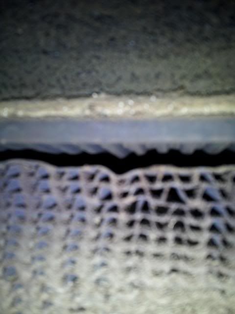

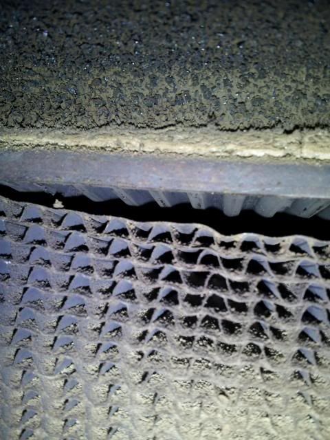

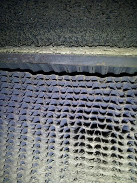

Since it's getting cold and I never cleaned the stove at the end of last season, I decided there's no time like the present to give this old pain the the rump a cleaning and get it ready before the cats and wife freeze to death.
I scrape most of the creosote off the walls, behind the head shield.. Then I decide I'd better check out the catalyst. It looked dirty, but I poked my head all the way up in there and saw something I didn't think was quite right.
[Hearth.com] BK Chinook Catalyst issues
That's the top of the catalyst. Anyone have any thoughts on this? I'm going to email it over to BK to see what they suggest I do and what happened. But I figured I'd post it up on hearth to see if anyone has had a similar situation.
This BK was used 2 seasons... 1 1/2-2 cord mainly Pine/Catalpa mix the first season, 1-1/2 cord Ash last season. All about 15-16% MC.

Looks to me like the gasket is gone. I think this might be an issue with the stainless steel cats expanding/contracting more than ceramic does, eventually mashing the interam gasket to pieces. Please let us know what Chris has to say about it.

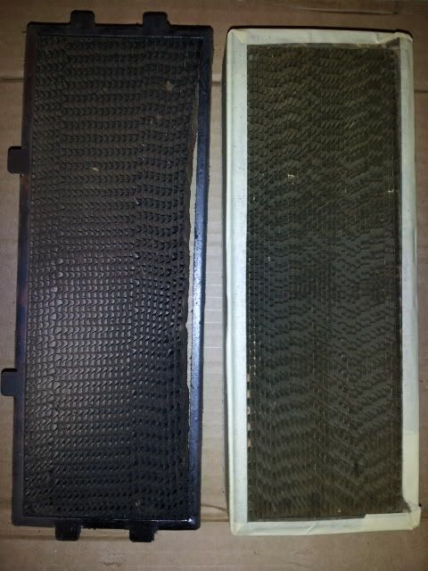

Got the new one. It looks great. Took out the old one, cleaned up the stove inside. Swept the chimney again for good measure since it was very smoky with the old cat at times. The burn was very inconstant, and would go out at anything under 1.5. I just wanted to make sure I got a good fresh start.
So I put the new one in, and the ENTIRE cat is glowing, not just a small portion of it. Not just a quarter of it for a few seconds then goes back out... but it's glowing steady.
I got the old cat boxed up, and I'll send it out when the Fedex truck shows up at work tomorrow.
Will update this again later, but so far the results are day and night. I'm surprised how much of a difference it makes. Here is a side by side of old and new. I would've taken better pictures but my battery died as I was taking them, ran out of power for flash. There's a nice little gap on the right side of the old one... you can see the cardboard it's sitting on.

It would be interesting to know if BK has seen this sagging issue before with the steel cats. Maybe they need a design change or just stick with ceramic?

I don't know where BK gets there steel cats from but they kind a look like the old Woodstock steel cat that had some problems. Woodstock took charge, asked for feed back here and worked with Sud Chemie to improve the cat.
I think it looks pretty much the same as what Woodstock uses. Sure, they collected a bunch of failed cats for testing, and replaced them under warranty, but I haven't heard one single word about the cause of the problem, just that the stainless cat is a newish technology under continuous improvement.
. . .on further reflection, I did hear a word about the cause of the problem. That word was washcoat. We must've gotten a batch of cats that weren't coated properly, or the replacements were coated better. . .something like that. Doesn't explain why my stainless cat still works reasonably well when wrapped 1.5x rather than 1x with gasket material. Doesn't explain what happened to Haas' gasket, which appears to be MIA. . .might think that his stove just shipped without a gasket on the cat, but that doesn't explain why his stove worked fine at the beginning. . .mine did too, BTW.
I don't know, I was looking at the new cats on WS site and they are different than what I had. The new s/s cat is seperate layered steel plates instead of the old one piece wrapped and crushed into a square. It also has it's own s/s bracket so you don't need to use the old cast iron one with gaskets.
I did swap out my old s/s cat with WS and exchanged a few emails with Tom but I never did push the issue to find out the problem, just thought they were busy and would take care of it and it looks look they did.
Yeah, I too noticed the new cat with the integrated frame. I'd have it, but the one for the FV has been out of stock. Does this mean that you're ready to try a steel cat again? IIRC, you went back to ceramic. . .
