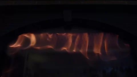

If the big BK is running on low most of the time for Texas climate, the fire show will be minimal.Well, I can't wait to see my King installed. I'm a pyromaniac and have a magnesium cone sitting in my back yard out of a huge rock crusher from my brother-in-laws rock mine. That thing can make some amazing fires seen by my neighbors who are over a mile away. Now all I lack is making that fire in my living room![]()

Oh yeah, I forgot to address that. He said he was a pyro; In that case, non-cat all the way.If the big BK is running on low most of the time for Texas climate, the fire show will be minimal.

If he turns up a King for any length of time, won't it get a bit roasty in there? Maybe not, with the vaulted ceiling.You'll get super high efficiency values, little to no show....want the show, just turn it up and it'll be less efficient, but not much.
