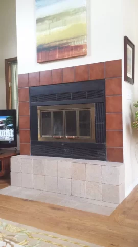

BTW, my avatar picture is before the drywall is finished. It's getting done over the next week but I couldn't wait to have the picture up. Here's what the old builder box fireplace looked like before:
