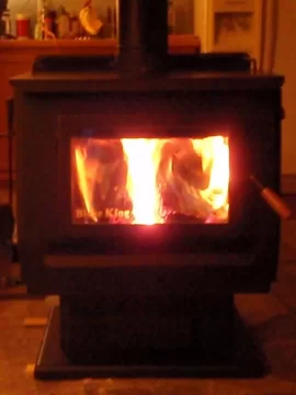

Time for show and tell.
I would like to show you my new fireplace insert, the Blaze King Princess. Fire box size 2.8 cubic feet in size. This is a Catalytic style stove that I read about on this very forum and decide to install. I use to have a Century insert but it was to small. I will be trying to heat 1931 1,500 story and a half house. The chimney is located in the center of the house and seems to be absorbing a lot of the heat from the insert.
I had to cut out the maple floor and then install 15.5 inch Italian ceramic tiles, I bought them at a outlet stove for .99 a square foot. Good place to go for small amounts of tile. The hearth is over 32 inches for the 18 inches that is required from the front door of the stove. This insert comes out over 13 inches onto the hearth from the fireplace. This provides a non combustible surface for the insert.
I am impressed with the burn times so far, I have had a 13.5 hour burn with usable heat and a restart after a new load of wood was added to the stove using Red Oak and bass wood. Also keep in mind it was only 35 degree outside the real test will be at 20 degrees below. I am in the process of learning how to use this cat stove. Dry wood is a must for the cat to work, high moisture woods cause the cat to not work correctly.
The insert also passed its City inspection today, so I am gonna have a cold beer!
Thanks goes out to the forum for all the great reads on this insert. I would have never bought it with all the the great reviews.

Congrats lanning looks great!!!! Im burning mine in as I type Kinda stinks but very cool to see it burn Btw is it normal to look like the fire is out when on low?
Congrats on the new insert, the burn time sounds great. Just bought a new home with an insert, right now I'm looking at the many choices that I have.
The install looks good. Can you tell me a little about the flush tile install? Did you morter up to the wood? I'm staring at 4x14 area I cut out to lay tile for an entry way and non combustionable floor under a Nap 1100cp.

Lanning, where do those two metal strips go? they were loose when I unwrapped my princess.
Id like to trade stoves with you, my plug is on the left and I needed a righty, Im going to have to get the electrician to put in another insert.

Nice! No fire in there though.... ;)

The flush tile install was done so we could walk thru to the left of the hearth in the the kitchen without tripping. We grouted the tile right up to the maple floor. Cut 2x4 with a table saw to the desired height and then plywood and durorock. Buttered the durorock to make the tiles the same heights as the wood floor. We never had to cut any tiles. Used some of the maple that we cut out of the floor to frame in the hearth area.

Metal strip are for helping you slide the insert over the hearth because of the leveling screws that in your case your gonna want to install. See LEVELING SCREWS on the bottom of page 10 in the manual.
The electric cords comes out the left of all the insert from the fan motor. The cord runs inside and around the insert and out the right side to the outlet. See ELECTRICAL POWER in the of page 13 of the manual.
Read the manual about 5 times, then read first fire on page 22 before you fire her up. Thats what helped me out. Jim

Thats Huge that you got installed and up and running! This stove is a machine, it works like one. I haven't had to run the the fan because it creates to much heat for the outside temps we are having right now in Minnesota.
I am really happy for you, Because I know how well mine works. Its a real quality stove!

As Lanning mentioned, those strips are not part of the stove. They can be placed under the insert to help you slide it in place. You might want to hold onto them for future use, should you want to slide the insert in and out.
Chop,
Surprisingly, it is normal for it to look like the fire is out when set to low. The fire is basically smoldering and the heat being generated is the smoke/gasses being consumed by the cat. As long as the cat stays active, you're good to go. Not pretty, but this allows super and consistent long burns, and excellent efficiency. Turn up the thermostat if you want to see flames. After burning on low for an extended period, you'll probably notice the interior of the stove getting dirty (especially if you're burning >20% MC wood). It's probably a good idea to burn the stove/insert hot for an hour or so everyday or two, this will burn and clean everything up.
