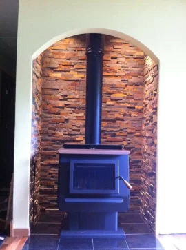

Do you have a plan for finishing it? A member here and co-worker of mine did this Bk alcove. It finished out really nice.

How much does that amount of stone veneer weigh?
I want to install a 90" X 88" area of a stone veneer like this in my install but I'm worried it will weigh too much.

I don't have the skills for that stone veneer, looks really nice but also would be way out of budget. Since my distances to combustibles are greater than the minimum, I was going to just leave the walls bare (painted type X). Then if they get too hot I'll do the Armstrong Metallaire ceiling tile panels.

That's fine too. There is no need for any special wall treatment if clearances are met. These stoves are tested to the extreme! The area around the stove will not be excessively hot, you can trust their testing.
I have a painted sheetrock wall within 6" of my BK's butt and it has never gotten hot. These cat stoves get hot mostly in one spot on top above the cat. You'll notice it when you see the stove top paint fade out.
