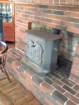

I beleive that is a garrison. They were decent onld stoves but a modern stove will perform much better. Is there a liner in the chimney already?
Yes, an old Garrison and possibly fired as hot as hades to keep old bones warm. This could be a challenge for an insert if he is used to that kind of warmth and keeps the place at 80º or higher in the winter. It also lacks the proper 16" of hearth in front of the doors.
Yes and you can see scorch marks on the floor because of it

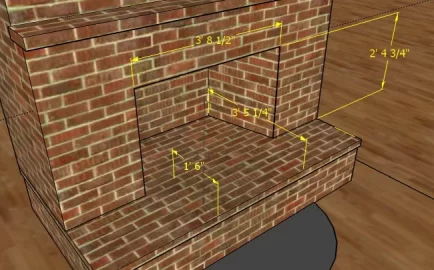

I think you can fit a Englander nc 30 in there with the pedestal kit, the height measurement is 29 1/2" from top of flue collar to the ground, that will be way cheaper than installing a BK, plus you can use the extra money in savings to install a new 6" stainless steal liner. Something to think about.
If you are going to change it this seems like a more easy path to get him to follow.

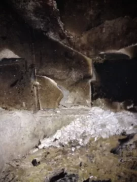

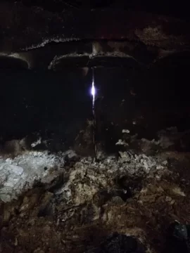

[Hearth.com] BK Princess questions Guys, the NC-30 just might be the ticket. I showed him the price (a huge factor) and the local stove place can order one. It looks like a go! FYI, this 85 year old climbs 2 roofs to clean his chimney every year. Ladder up to first roof then a adder on a roof to get to the next.
His doctor said no more. Will he listen? Doubt it.
Is there anything wrong with the stove that has not been wrong for the last ten years?
Dunno, you tell me.[Hearth.com] BK Princess questions
There's also a 6 inch length crack directly in the back with a 1/32 inch gap. Cracks everywhere. Amazing. Burns 5 cords in this every year.

First double check and make sure it will fit in there, order a liner and do a block off plate.
