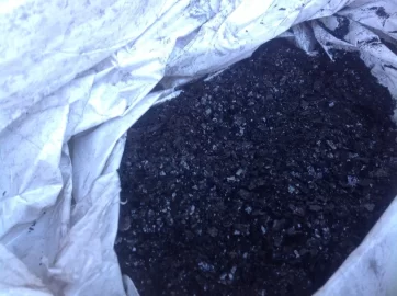

It was warm today so I decided to clean out my chimney for the first time ever after burning the last two months. So when I looked inside the pipe I found light brown dusting on the sides. so I said okay not too bad. But when I was cleaning up the pipe black crystals were coming down from the top part area. Is this because of the colder temperatures up there and my 15° offsets that this is building up. Also from not well seasoned wood. Is this something that I should be concerned about. Or I need to run hotter fires or get better seasoned wood. Will this lead into more problems.

I believe that is stage 2 creosote condensing on your flue.
You really need drier wood as you already know.
I doubt the offsets are killing you.
If you insist on burning suspect wood keep the temps a little higher but it may not help much way up there.
I get it on my cap with really seasoned wood even, mostly because i have a cat stove with very low stack temps.

If it was me I would check it every month. It's going to just get colder and that raises up the chance of a lot of creosote.
Just don't go with the thinking that doing a hot fire once a day is going to solve anything.
You could mix in some bio bricks or some old lumber/pellets but that won't keep it all away.
Just clean it in 4 weeks again,or at least check it out.

For sure. It doesn't take long; check it monthly. Hopefully you already have next year's wood put up. If not, time to get busy. Better yet, get yourself 3 years ahead. It might take a couple years to get there but the benefits are well worth the time and labor.
I will have about a cord and a half for next year that's already split stacked and waiting. I think I will send the brush up the chimney once a month. only takes me 20 minutes so better off doing that once a month then running into a problem. until the wood is better at least. Thanks for help.
