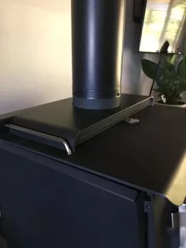

Just yesterday I did the same thing as you. Painted one section of pipe (the little 6” appliance adapter)with rustoleum but my duravent telescopic section right above is the original paint. The rust oleum color is pretty close to the stove color so I’m okay with it.
If all else fails, replacing the telescopic section was like 150$ and easily replaced.
  • [Hearth.com] Black paint match for DuraVent?
Satin Stove Bright is what matches. They used to offer Stove Bright in Dura-vent touch up. Dura vent switched to satin and they no longer offer the touch up. It didn’t match perfectly, neither does satin. It’s really close though.
