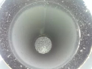

I just did the same thing yesterday. I'm new to wood burning and I have a new stove installation and chimney. I just finished installing it about a month ago. Took my cap off to check and make sure that everything looks ok. After burning about 4 weeks of poplar and oak, mine looks exactly like you are describing - black shinny stuff in the cap, but the rest of the chimney is mostly clean with some grey / black powdery deposits. I attached a few pics. I think this is normal.
  • [Hearth.com] Black Shiny tar
Hobbes, you are doing just fine. One little note on your screen. That is what will plug first. If it is possible to reach that screen from the outside with the poles you use for cleaning the chimney, many times you can just lightly tap the screen and the junk will just fall off. This will save you having to go up top with a wire brush so often.
