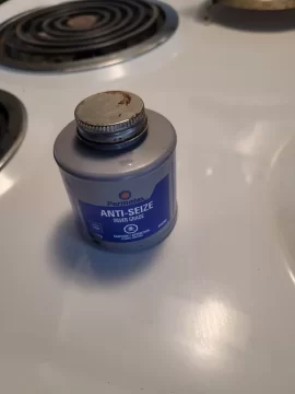

Yes, I had it happen to my Princess a couple seasons ago. That was after 5 season of use. I used Permatex anti-seize and it's been cured since.

My brand new osburn 2300 did this last year.i was using wd40.the response from sbi was DO not use that or the door handle will seize right up.anyways I started using anti seize once a month and all was good.my friend has the regency 3100 and he had issues as well until he used the anti seize

Once you have the roll-pin out, you can pull the shaft of the handle out of the nose block. We use dissimilar metals to avoid this very issue. You may be able to use a small abrasive file, Scotchbrite or other material to clean up the fit and then lubricate with anti-seize. Reassemble.

Thanks for the tips. I was able to fix it. The only flaw is the allan wrench, there was not enough clearance on this newer model between the screws and the metal trough that holds the braided rope. I debated shaving a 1/4" off one allan wrench but I was able to wrench them off with small channel locks. Then had to apply a little PB Blaster to the pin for the flat tipped nail to pop it out (good tip using a nail). A little more PB Blaster to get the seized housing knuckle off the handle. A little work with the orbital sander on the handle, some anti seize, and now shes back to show room ready. Hoping this is the only issue I run into with this stove.
