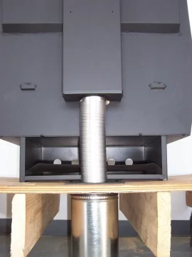

Yes you can add a F/A kit to the 20. Your dealer can order one for you. The first step is to determine whether you will exit through the floor or wall. If you have the SC20 with a pedestal, you can consider either option. If you have the leg version, the 3" F/A line will be visible if you run it through the flow. The kit we sell is for a floor install, but plenty of folks here can help you with the conversion to a wall exit.
Just keep the entire F/A line below the bottom of the firebox. ((Don't create a snorkel) These images are a cross section on a Princess, but it's the same basic kit and install.
Very nice, Thank you. Pedestal base, and will be doing a wall exit (slab floor). I'll be ordering the kit soon.
You may save some $$$ buy just ordering the adapter plate. Part number #S.FA.PLATE3
The kit has more than you need for a wall exit. Contact Highbeam. I think he did wall exit. He had pictures posted of his hearth renovation a year or two ago.
My OAK system goes vertical down into the raised hearth where it then drops through the subfloor into the ventilated crawlspace. You can use "dryer vent" type semi rigid metal products and/or rogod HVAC type ductwork from home depot to get this done. The only BK part you will need is the plate that screws on to the stove to give you a 3 or 4 inch snout to start with.
