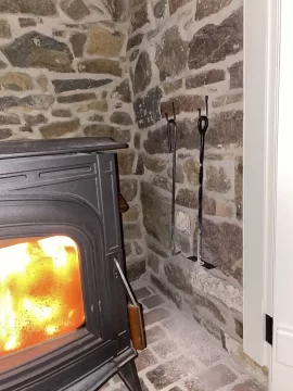

I just dug up a photo from a few weeks ago, when I was grabbing a picture of an ash rake for another thread, which happens to show the stove when running on a higher setting:

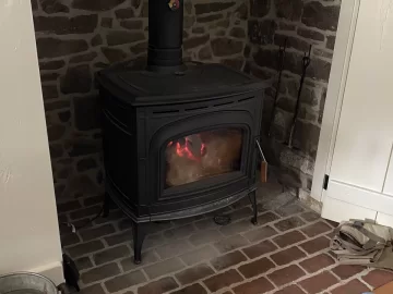

And here's another photo taken just now, about 16 hours into a burn on a medium'ish setting:

Also note that this is a BK Ashford 30.1, roughly the same size as the Princess, but with (I believe) a slightly more aggressive air wash system behind the glass. This means my glass likely tends to see slightly more fly ash and less creosote, versus a Princess.

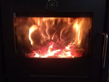

After running low for a few fires, a high run today. This is half an hour after reloading. Glass is almost clean.
Pine and two maple splits. 60 pct full reload. Hands burn from radiative heat after 10 seconds when taking the pic ...
