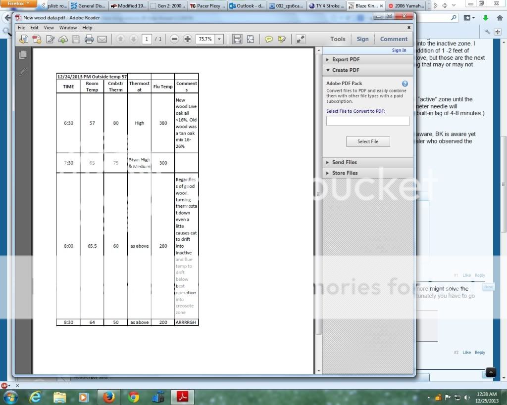

The issue remains the same despite good wood (with BK's moisture meter readings below 16% on all pieces of live oak): I cannot sustain heat or a clean burn unless thermostat is at 100%. Per BK's manual: "Any thermostat position between 1 (low) and 3 (high) will produce the desired clean burning characteristics." If mine is turned down to even 2.75 the stove does not continue to burn clean, flue temps drift below 300 and combustor thermostat drifts into the inactive zone. I have no obvious problem with draft (smoke stays inside the box with door open and with or without bypass open. I have doubts that an addition of 1 -2 feet of extended chimney (mine is at 14' vs. recommended 15') or double wall stove pipe (mine is single wall) will solve this issue with a new stove, but those are the next steps per BK. However, I do not think this stove is functioning properly and I am reluctant to spend more energy and money on something that may or may not work.
Today's data with new wood is attached.

I made a jpeg of the data.
[Hearth.com] Blaze King Sirocco 20 Help thread #2
