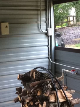

Yeah a mist system on your wood shed is a most.;)
I can’t resist. Misters at each of the four corners and a couple water lines if more moisture is neccessary. I thought Lsucet in particular might appreciate the photos.

To the OP, just to be clear, this is all in fun. It is FAR more likely to have wood too wet (its natural state) than too dry. If you’re really at 12% measured on a fresh split at room temperature, you’re close to being among the very few.
