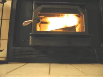

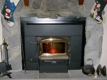

pic of my insert in a Majestic ZC
  • [Hearth.com] Block off plate for zc fire place..is it nessesary?

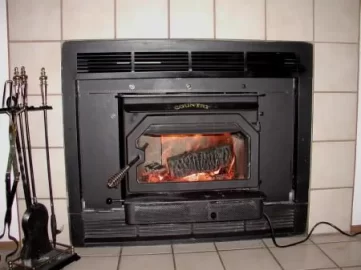

so are you saying this is a improper install ? with vents covered. The shop knew this had louvers, and said they do them all the time this way.
We install them like that also, if the panel is not tight against the box and it doesn't have insulation in it the cooling vents could still circulate fine I think.
