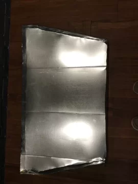

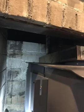

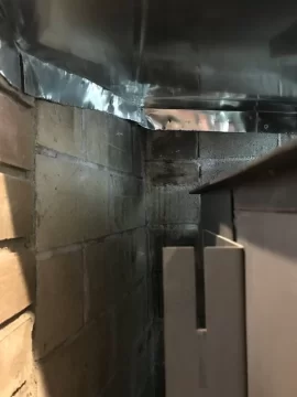

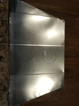

Here are some partially finished photos. I am admittedly not a metal worker but it is turning out ok and it is a tight fit. The photos show she plate cut out before the flanges are bent, after the flanges are bent, then a partial install. I cut the plate in half once the measurements were accurate because this is being installed post insert install. I insulated really well above the plate before install.

Thanks and looks good. I like the idea of cutting it in two. That may be what I will do also for ease of retrofit installation. I’ll assume you’ll silicons the edge/flanges and anchor into the brick? Will you also place rock wool on top?
Yes, once everything is where I want it to be, I will anchor it to the brick with Tapcons and seal all of edges with stove cement/some kind of high temp silicone/sealant. And yes, there will be insulation on top as well. The package of Rockwool I bought has more than enough to do the top of the liner and around the insert so I will probably stuff the extra up the chimney around the liner as high as I can get it.
