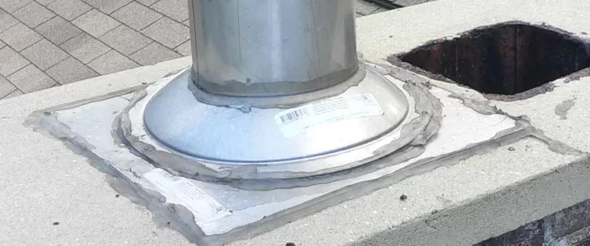

On the top, you should see everything caulked with silicone. Here's a picture of mine, you can see the top plate caulked to the cement chimney cap. The storm collar caulked to the top plate, and the joint where the liner passes through caulked as well. Even the clamp & seams of the storm collar were caulked. You get the hint nothing should be left uncaulked and it should be RTV silicone, hard to tell between regular.
If you find problems, you're in for some work. Silicone can stick to almost anything, but it WILL NOT stick to itself. If you go up there, and some of the seals are blown you need to scrape off all the Silicone and reapply. In this picture, you can see my storm collar seals have blown and aren't sealed anymore to the top plate (you can notice it particularly below the storm collar sticker). I scraped it all off and reapplied. The best way to apply it, is to apply the silicone underneath and push it down so it glues the system together than it is to put everything together and afterward silicone around the joints.

Ah silicone, now thats a subject I know quite a bit about from my roofing & siding days. Silicone is really not the best sealant for alot of applications. Or at least normal silicone caulk isn't. Silicone can be applied to itself. The trick is and even in a fresh install of it, you must work it into the surface you are sealing. Just gliding it on or globbing it over does not last long. No matter what the surface, we used to use our finger and work it in, usually in a circular manor. Looks almost like a welding weld when done. If its a striaght line like a corner or such, run yer finger and smear it in one direction along the seam, then reverse and run your finger the 180 degree opposite direction. I found that only good for tight corners or 90 degree seams. I have put silicone over old silicone and it stuck just fine. But I worked it in real good.

BTW, that storm collar, shouldn't be sitting on the plate, it should be raised up a few inches. Not trying to be a knowit all, but this stuff I truly have dealt with for many years.

Boy Hogwildz, that was a very useful post. I'm replacing and caulking windows and I'm glad you went the step to say how it should be done, I've been having a very hard time with the corners of the windows, now I know with the finger one pass down, one pass up. I followed the directions on my liner setup (Heat Fab) which wants the storm collar resting on the top plate, possibly others don't. I did see the instructions say use silicone for the top plate to the cement cap (my guess silicone can handle higher temps than urethane (500F vs. 250F)), but I just realized it doesn't say to caulk the storm collar. Maybe I wasn't supposed to go that far with the caulking.

The top of the collar around the pipe should be caulked. Thats basically all that keeps rain water from running down the pipe behind the collar. I know it seems like such a small crack, but rain will run down there. I had to point that out to my old neighbor when he complained about his roof leaking. For the most part, shingle roofs don't leak at the shingles often. Its the flashing & penetrations that leak. Alot of homeowners just don't realize this. I would caulk the top of the storm collar, but not the bottom. This way if water does get down around the pipe for any reason, your not sealing a pocked for the water to build up in. if the bottom isn't caulked, the water will just run out and across plate and off top as it should. I would also seal where the pipe comes through the plate if you didn't already. But lose the caulk on the bottom lip of the collar, thats just asking for trouble. Water dam.
