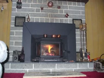

So after 2 winters of dealing with the Most Evil Exterior Chimney and an installer/dealer who not only refused to do a block-off plate but insisted the solution to my not-enough-heat-out-of-my-insert problem is to---get this--- '' remove that stupid, useless baffle-thing the EPA makes them put in there'' (wha.....???) I decided not to deal with him anymore and get somebody else---yeah, duh. Anyway, they're coming to sweep the chimney and give me an estimate for the block-off and I'm wondering if I should have him insulate around/behind the insert instead (cost/evectiveness/ ease of execution). Would doing both be overkill and cause a meltdown and/or is either one a better option? I not only have the evil exterior chimney but it's an old 50's heatform type with the vents. Thanks guys.
  • [Hearth.com] Block-off plate or kaowool wrap? Or both?
I installed my Summit in similar older fireplace. I installed block off plate below damper area myself.
Putting some insulation on top of the block-off plate instead of around the insert would be a reasonable solution.
blockoff plate needs to be there anyway. insulation may help depending in flue size and height. hard to make that call without knowing all specifics, when the other sweep comes and does the flue , be there! see what he gets out and see what he thinks based on what he gets out.
BTW your origional dealer who suggested you voiding your listing by modifying the insert(removing the baffle) is an IDIOT. glad to see you sought a second and hopefully better (couldnt be worse OMG! ) opinion.
Thanks Hog---I know you did---followed your thread then because our set-ups are so similar. Belated thanks by the way for the tip about closing off the vents---made a big difference. I hadn't found this site until after we had the stove in and were already burning, then the next season after I knew more I asked about having the block-off put in but the guy poo-poo'd me as a stupid woman. We started burning early last year and didn't have time to get somebody else. DIY is really not an option as I'm 112lbx. soaking wet and the Man is not---uh,---mechanically gifted. So did you also insulate around the stove in the fireplace box itself or do you find the block-off sufficient?
Believe it or not, he told me that it was the manufacturer's advice to remove the baffle, and that he now does it with all his stove installs----and doesn't even inform the customers. When I asked him about voiding the warranty and/or overfiring the stove he said, ''I just won't tell them.''
For specs, it's a 15ft. insulated ss. inside a masonry exterior chimney---double flue with oil furnace----fwiw if the furnace is off we lose so much heat into the masonry that sometimes we can't even keep the blower running. We really only meant the insert to be a boost and not the sole source of heat but it makes me nuts that it could be doing so much better.

I just did the block off plate. I did have a lil kawool left from the old Fuego flame block off and layed that on top of the block off plate only. Prolly ain't doing much.
Me personally found the block off plate more than sufficient. To insulate around the insert walls or top itself.... I just don't know. I actually want the masonry around it to soak up some heat to release slowly later, when stove cools or I should say if it cools. I want the air to circulate around, and I just fear not letting it breath would possibly make it run too hot, or get the casing too hot.

well it sounds like the act of burning isnt an issue but heat retention is. that fireplace is a rather large thermal mass and getting it heated is probably a chore, BTW does the fireplace have a clean out that leads outside? if so make certain it is shut and gasketed. this is an unthought of sneaky leak that can let in cooler air which can keep the fireplace cooler.

Yeah, I wondered if it might be a bit much to wrap the stove, but I had read a thread here about it and wondered. I get it about letting some of the masonry heat up but man, over half my insert is in the fireplace and over half the fireplace is outside on the front stoop! I'll definitely get the block-off done one way or another.

No clean-out Mike but still getting it heated is 'a chore' to be sure. Wasn't it you that wrote the post about wrapping the stove btw? I have it printed out somewhere and was gonna send it to 'the stooge' who wanted to ditch my baffle.
Ah, see my chimney backside is not inside my soon to be new bedroom. So any heat that absorbs through now goes into the bedroom. Its not much, but it is a small amount.
You could try and insulate around it, but not sure how tight an area you have, and I am just concerned about concentrating heat that I am not sure manufacturers designed for.
