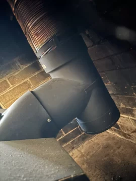

I guess my ignorance is showing. Here’s a pic behind the stove. What do I have?

Being new back then, it's understandable. The liner in this picture is uninsulated.

It's possible. Verification requires eyes on site.

Is the stove pipe a double wall?
All I see of stovepipe is a picture of the tee. It doesn't look like double-wall from 2500 miles away. :) Is the original invoice for this work on file? If so, what does it say was installed?

Also, do you have any comments about the discolored pipe?
