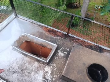

I have posted before about my ongoing downdraft problem. The fireplace, and now stove (Oslo F500), just has a terrible cold draft that makes cold starts in the stove tricky (and smoky). We almost have to run the stove continuously to keep the cold air out. The chimney pipe has 1/4" insulation I just realized. Chimney pipe is at least 16' tall. Exterior chimney on a north wall in the shade.

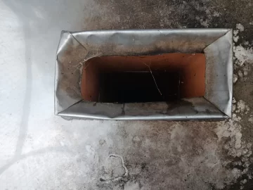

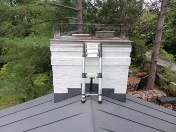

The chimney guy is here now, and he is pointing out that the attic vent is just next to the chimney pipe, and maybe cold exhaust from the attic is just going directly down the chimney pipe. The intake for the attic is a gable vent.
He said that either covering the attic vent or setting up a metal divider in between the two holes might solve the downdraft problem. The photos will help clarify the problem. Attic vent is on the left, and stove pipe is on the right. What does Hearth.com think?

I think the attic is always warmer than the outside air in winter. Even for a vented attic.
So I don't think that's the cause.
A divider is good nonetheless to avoid smoke going into the attic vent instead.
And air sealing the boundary between living space and the attic will help a lot

Just a guess here. Is there a ceiling vent grille upstairs that connects to the attic? If yes, it will create a chimney effect in the house causing negative pressure downstairs. That's intentional, to vent heat out of the house and up through the attic. The house I grew up in had this setup. The solution is to block off the vent, at least in the winter. That used to be my job as a kid.
I've never seen a "flue" used to vent the attic...is that common?!
There has to be other vents, no? I'd block that "flue/vent" off, if possible.
The attic should be drawing air in down low and venting up high, not drawing in above the peak! Does this home have gable vents?

I can say the other chimney (which doesn't downdraft, it's an interior chimney which makes it SO easy to start) has 3 separate flues- one for the wood stove/fireplace, one for the gas furnace, one for the attic vent. Yes, there are gable vents in the attic. I think of the gable vents as intake vents and the chimney outlet you see in the pics as outlet of warmer air. I thought that was "code". House was built in 1950.
I see a cage around the chimney. Is there a cover on that normally?

Also, the upper chimney flue should extend 12-18" above the other flue pipe to eliminated siphoning. Homes with multiple fireplaces often experience negative house pressure issues. Negative pressure pulls smoke from the upper floor chimney into the lower floor's. When the upper-level fireplace height is increased, it prevents smoke from being drawn down adjacent flues.
Reactions: newatthis
Try leaving it off. If you stop the smoke from rising out of the way, it has more time to get sucked into places you don’t want it.
